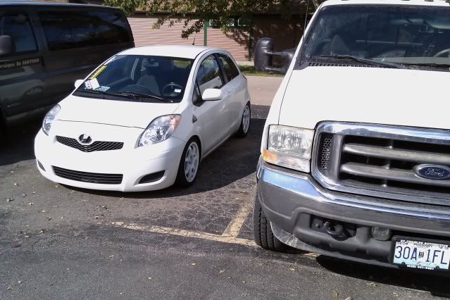

Hmmm I have Basics and my car is one of the lowest on the site..... :)
But I work at a performance shop that specializes in SCCA cars so our head mechanic did some work to them, im at about 3.2" front and rear drop wise on Tein Basics! I still can go almost 1 more whole inch on mine. Megans you can set your frame almost on the ground but you cant drive it that way.

im on kido coilovers and i sit 3 inches from the front bumper to ground
^^^ what he said, whoever thinks you cant slam these cars is nuts!
A lot of us are doing it now even though its neck breaking haha
