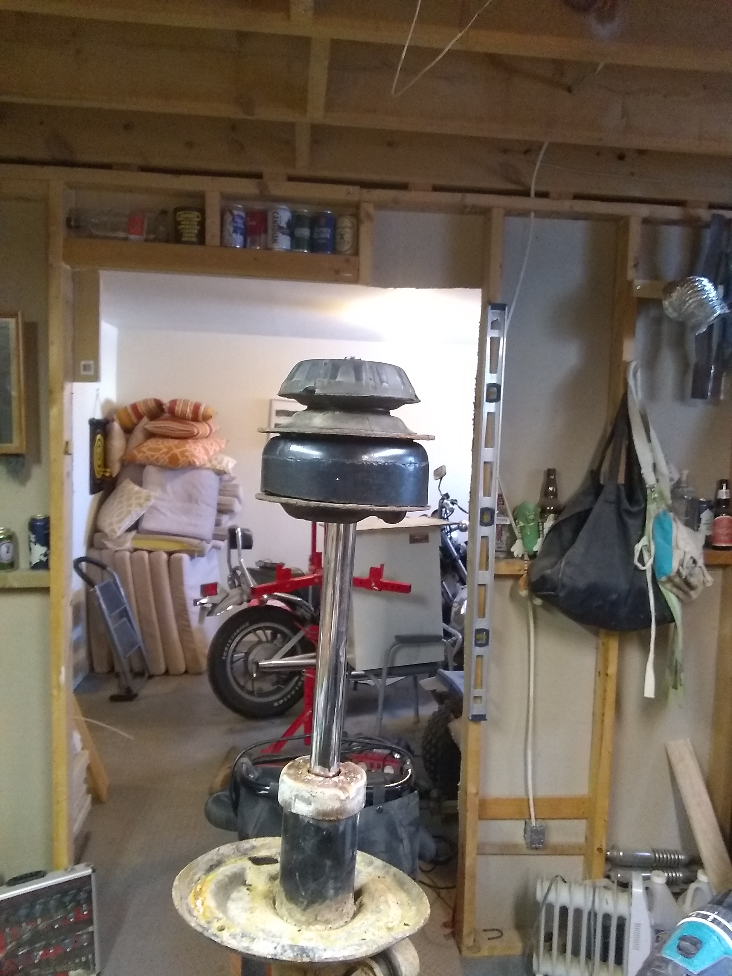

Here is one of the SX4 kits installed, it's the same kit as the Ebay one I found basically.
![]() I think if I get some used mounts (wish I kept mine) and figure out the bolt extension I can lift the front the same way cheap. |

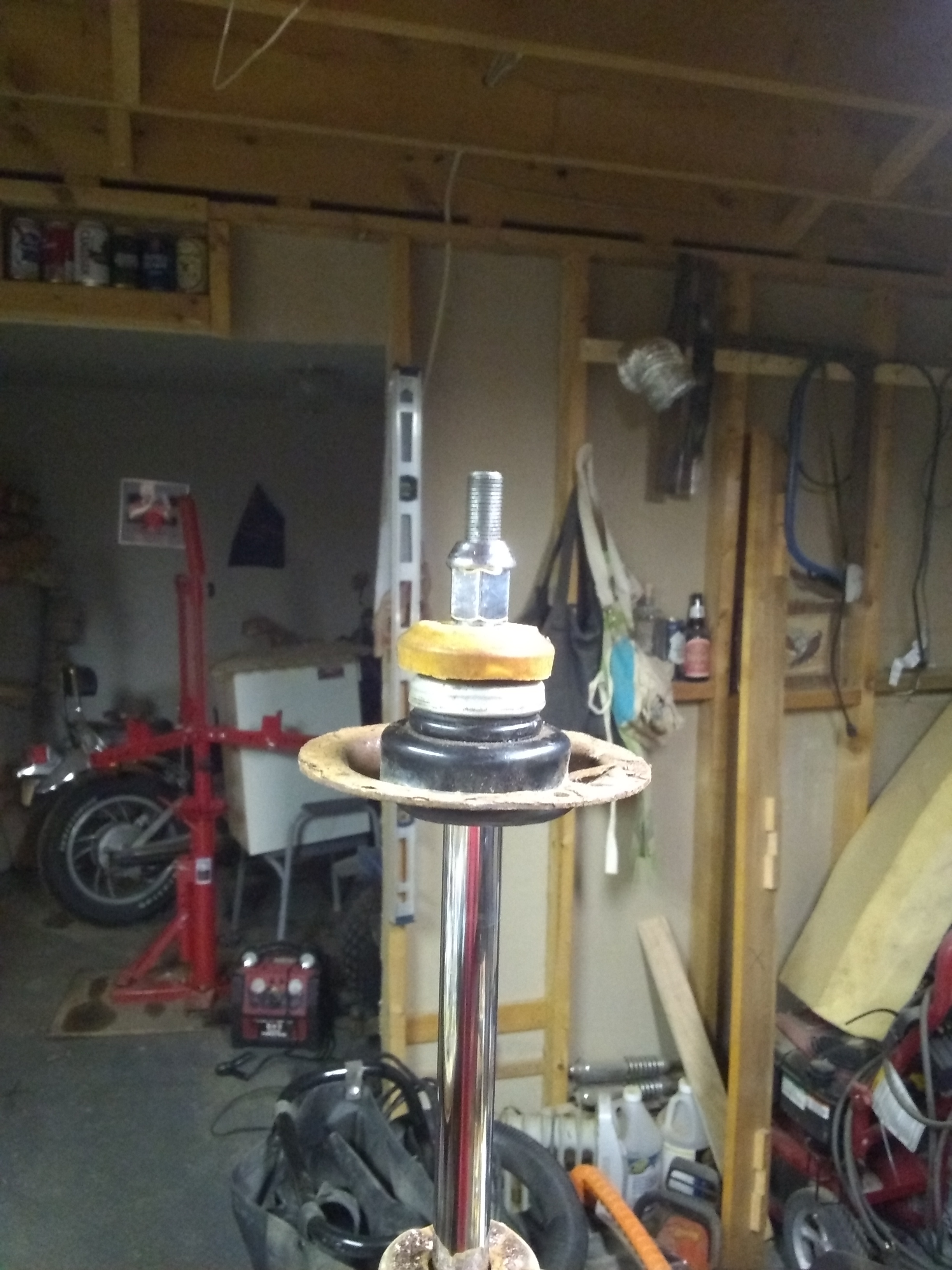

Didn't get a chance to work on the lift. The plan I have is to cut off the ends of the old strut shafts, then use a deep bolt, like a lug to attach it to the new strut tops and extend them, use a second set of mounts and stack them just like the Ebay kits. I just need to research how much thread contact will be enough to be strong enough, I may need to have someone weld it. I have the M12x1.25 lugs and they have about 1" of thread in them so just the threads would be .5" engagement on each half of the extension. I have an engineer buddy I can ask about it once I build it. From my measurements though I'll be able to get as much as 2" of strut extension from that setup. If the engineer says the 1", .5" each isn't enough strength the lug has 1.75" in total length, just the .75" has no threads so I could have the stud welded in there and give more thread engagement on the lower shaft if needed. The Russian kit doen't look like it has much more than .5" of thread on it.

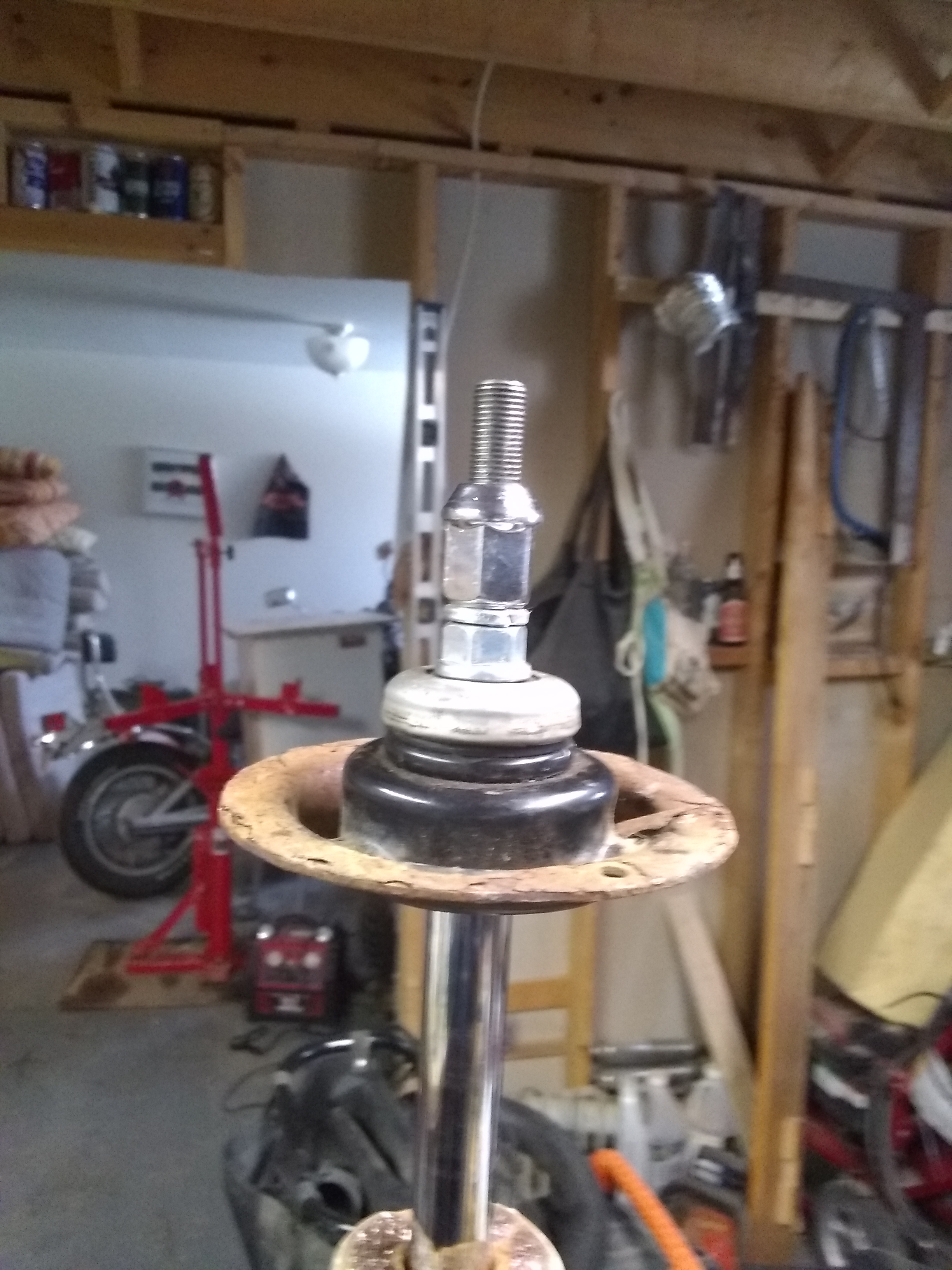

Got grinder to work. This much so far. I think it will be plenty strong. Working out how to gain the 1.5" needed under the mount.

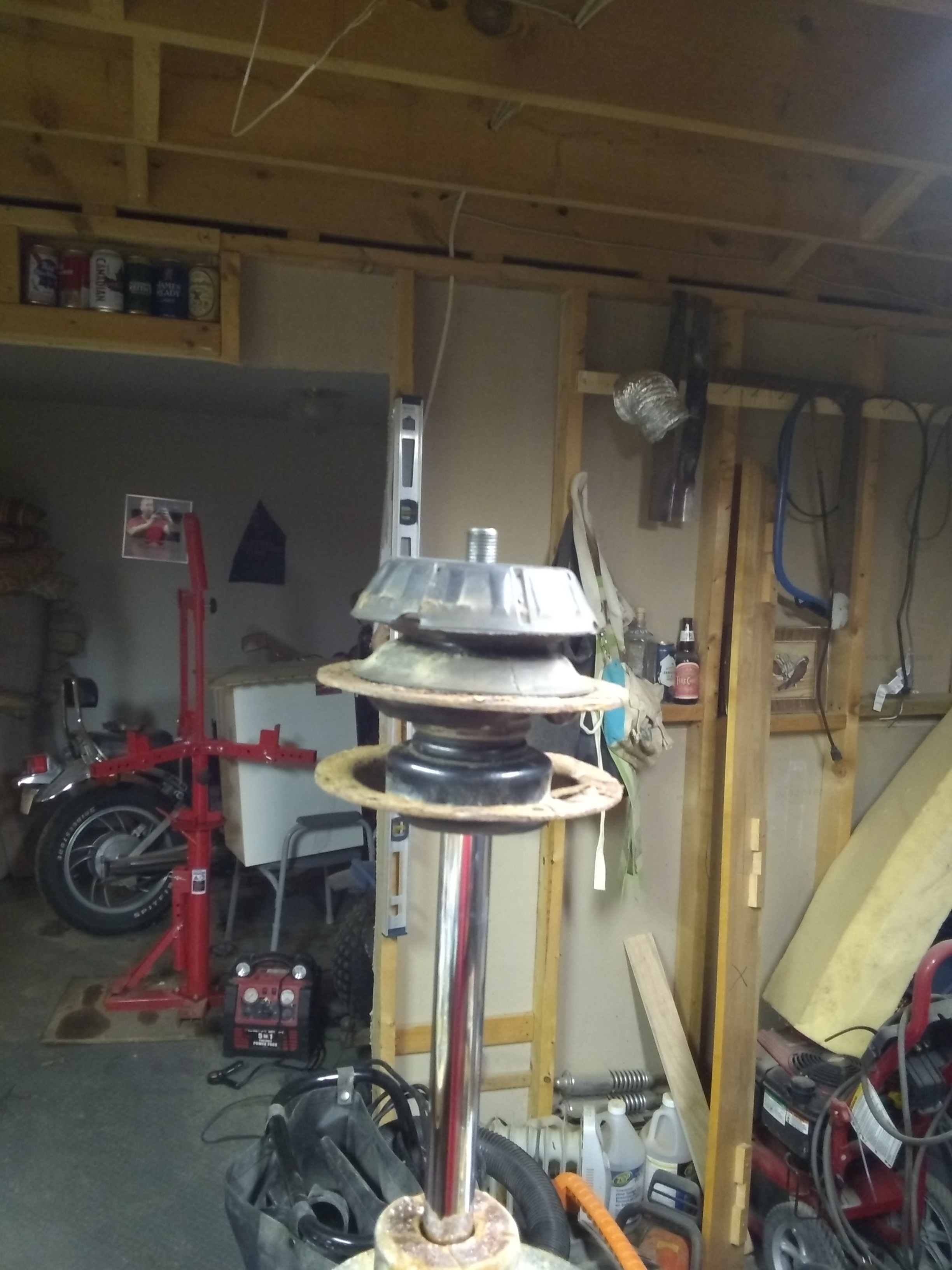

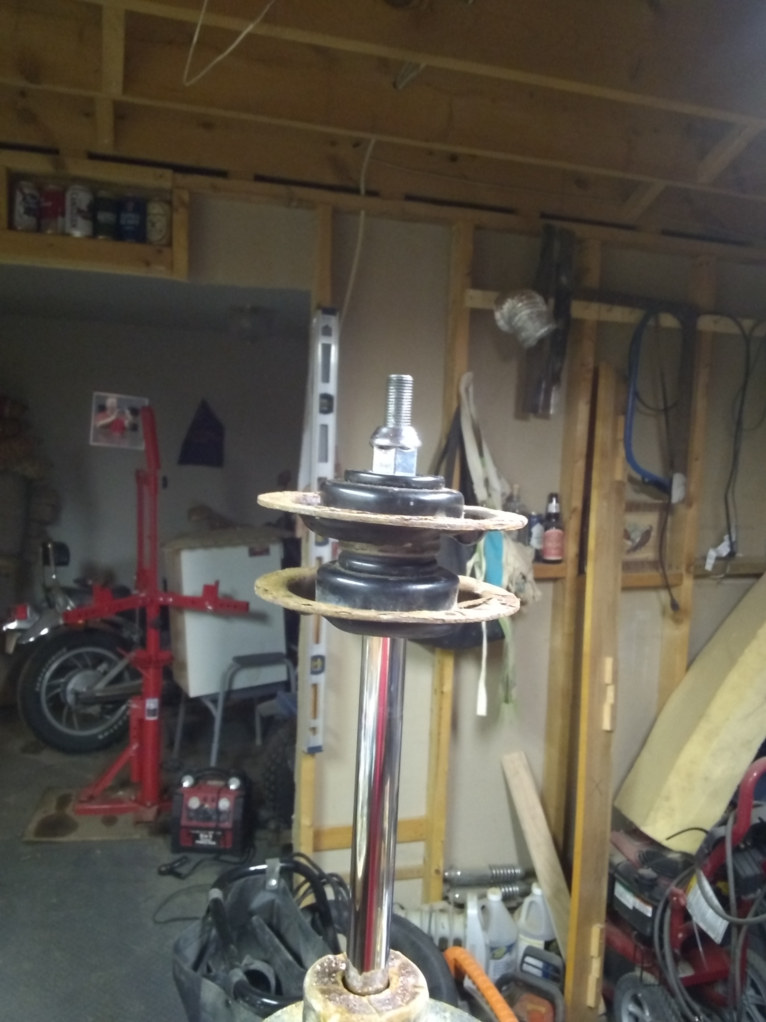

Ok. This is a start. I can do 2 of these. There is 1.5" between the 2 spring perches so now just need something as the meat in the sandwhich.

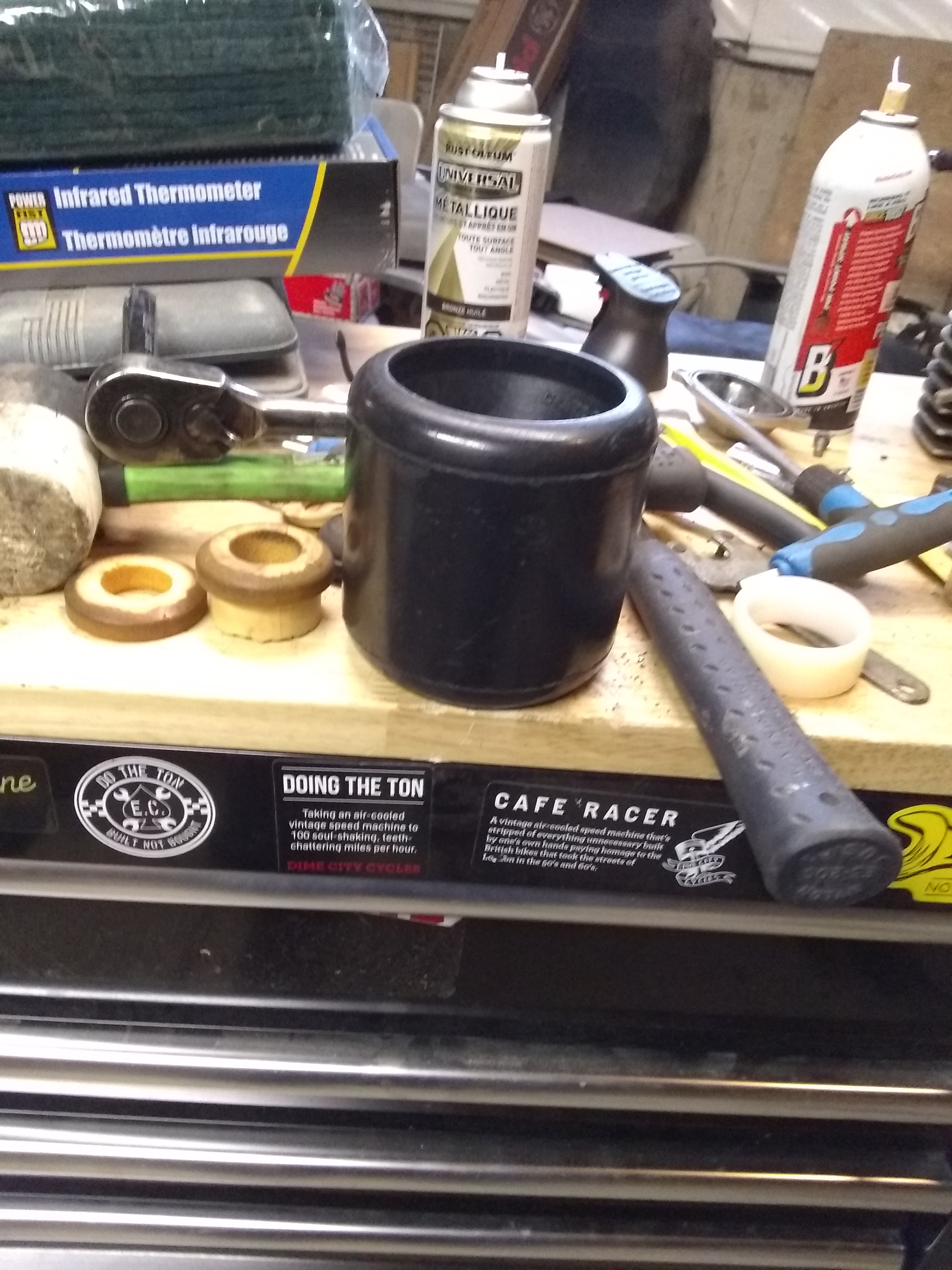

Trip to ct and found this in the boat.section. high density boat roller. Uv and salt resistant and can carry a huge boat on it.
![]() Cut an inch and half slice and Roberts your mothers brother. ![]() Sent from my moto e5 play using Tapatalk |
