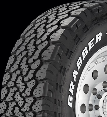

I have the General tires on my Jeep XJ. So far, I like 'em enough. For my Yaris, I'm running the prior gen of the BFG All Terrains in 195/70-14 (70, I think). They hold up well for daily driver duty.
