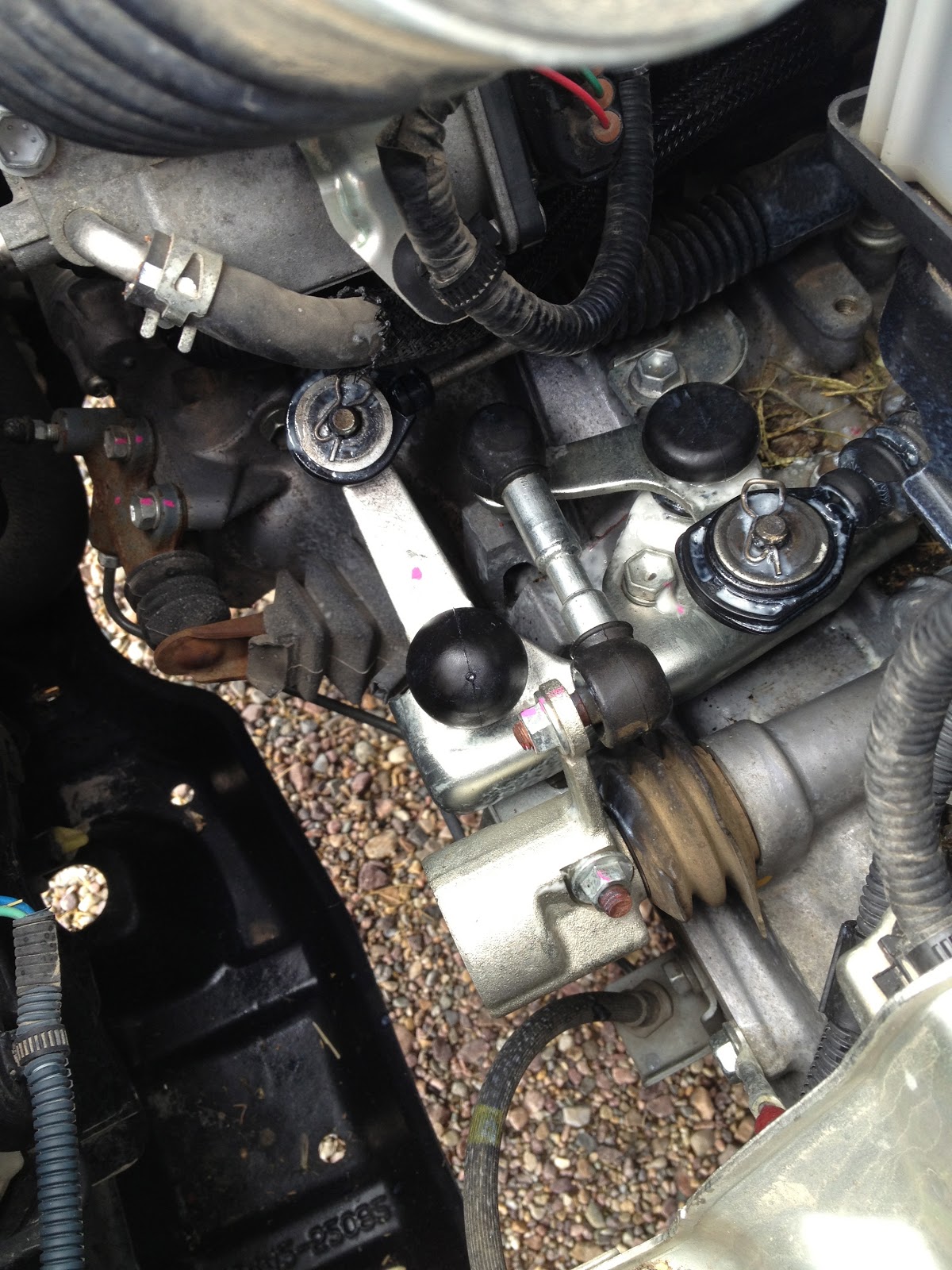

I had the same squeak. I'm at about 83,000 miles. If you like instant gratification, this is a good one! WOW! Problem fixed the INSTANT i sprayed the part highlighted with the yellow circle and two yellow dots. WAY smoother shifting now, way less friction!. Huge difference (and I just changed my manual transmission oil to the Redline MT-90 stuff, and that helped slightly but was nothing compared to lubing these shifting linkages). I used Johnsen's Multi-Purpose Silicone Lubricant. Time will tell how long it lasts. If it lasts a long time, good, if not, next time I'm going to use a White Lithium Grease Spray. I removed the intake air filter box to make the access easier, but it's not completely necessary. Also, while my friend moved the stick through the gears, I sprayed all the moving parts, not just the "yellow circle with two dots" part. Thanks guys! This is a great forum!

I sprayed lithium grease on the linkage with great result the squeak disappeared.
But is it a sign that there's something wrong with the linkage? Like it needs to be replaced? because it's worn or something etc.

Fixed my squeek with this as well.. first tried the silicone spray.. lasted about 2 weeks.. came back with lithium grease the second time.. been squeek free for a couple months now. :)

Yeah I was also using silicone for this, but it turns out that stuff only works while its viscosity is just right... After that it ends up making things worse, according to the mechanic.
