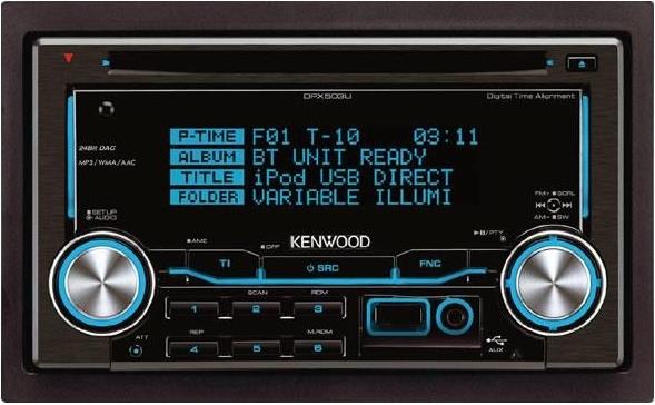

Here's the deal:
If I buy a CD player like this one for example:
...where can I put it?According to this image above, could I place it in No. 1, No. 2 or No. 3?Can I choose where will I place it for a simple cd like that?
Another a question...in case I want to place something like that:
...in which place of these three spots will go?As far as I can imagine the man who will fix it for me will take off the plastic in No. 2 & No. 3 right?Above the ashtray and below the A/C.
Please answer my questions...
George

Well looks like noone is answering yet... Im guessing you have the 1st gen. Not Familiar with it.. Your steering wheel freakin rocks btw.. did that come from factory like that o.0.... ok.. For the 1st radio.. Im guessing the best placement would be around 3 with a custom placement. The 2nd Kenwood would most likely take up 2 and 3 also with a custom fit.

slygeo87: to fit a double din, you would need a new trim kit (i'm not sure if you can find them in Europe) because your radio is integrated.
I've seen some people installing a single DIN radio in #2, i think it's the best way to do it.
this is my OEM radio
this is my nakamichi CD500, sorry, no better pic than this lol

Cool man, thanks.Over the 'alarm' button is there a hole?How come?

because we do not have the integrated radio and the display here.

Ok, I've made up my mind for the second picture head unit.The big one. :P
Can somebody tell if it will fit in an old model yaris please?
/edit: Do I need a 'trim kit' as well?Please answer...

Somebody please answer....how can I find a mounting kit for a DOUBLE DIN receiver?Please tell me......: ( :( :( :(

http://www.yarisworld.com/forums/showthread.php?t=788
Try google: Metra dash kit
Try ebay: dash kits
Hope this helps.
I'm sorry... I do not have the part number handy. It is an OEM toyota part.
try search the forum, CScott posted the part number a while ago..
It looks like the US 2002 echos used a radio similar to our current Yaris radios (20mm wider than standard double DIN).
The part number for the US trim is: 55406-52010-B2
To mount a standard radio, you would also need a kit like the Metra:
Double DIN radio: Metra 95-8202
Single DIN radio: Metra 99-8201
