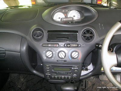

My dashboard before I've installed the gauges, just a bit boring, so i thought I'd pretty the thing a bit....

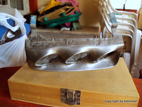

Got the tape of and stuck it on a thin sheet metal, the thinnest i could find, and with metal cutters started to cut the template out...
Then I started to make the base of the holder from the cut metal and glued the ends with epoxy cement .. I held the ends together with laundry pins...they should hold...hahahaha all i coul find...

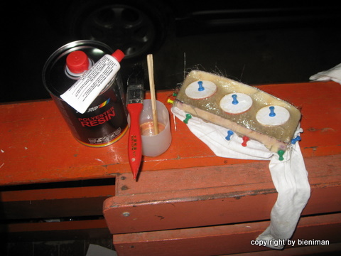

I then cut round shapes from hard plastic, the size of the gauges. And sawed a small piece of cardboard, about the size of the base of the holder. Also I sawed 3small pieces of a broomstick, which will hold the plastic circles and let them keeping looking at an angle...Sorry also have no pics ...

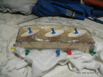

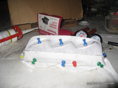

Put everything together(wood,plastic metal) and covered the whole thing with some cloth or stretchy material, so you'll get natural curves...I've put the whole thing together with pins, I know it's confusing but you'll get the point after seeing the pics....
O, almost forgot, I've cut 2 sets of plastic round thingys. They should hold on both sides of the cloth, inside and outside...

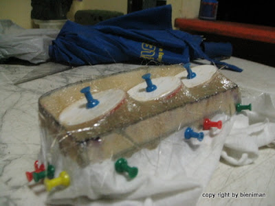

Mix up your resin. Careful!!!! these fumes are harmful and be sure to take safety precautions. I've tried a bunch of times to get the right mixture, mind you it's my first time working with resin. After mixing it up quickly apply resin to cloth with a small brush... then apply fiberglass in small pieces, just rip them off the larger piece...Use a lot of powder before handling fyberglass, these things are very itchy...WORK FAST,THE RESIN IS WAITING ON NO ONE>>IT HARDENS FAST AS HELL>>>>
Now you'll get one sticky mess..., let it dry and harden..
That's the stuff!!
let it harden overnight..

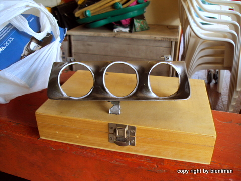

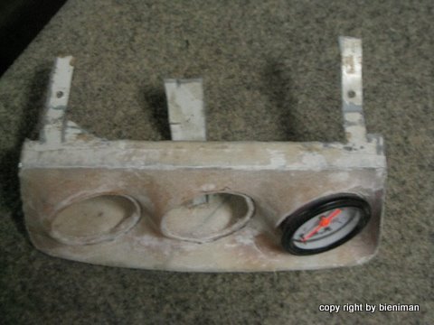

Now comes the fun part.sanding down...
If you can, use power tools, I used a Dremel tool to sand the thing..its easer..
the results
Now, get some paint on it, I sent mine to a paintshop, they did it for freee....

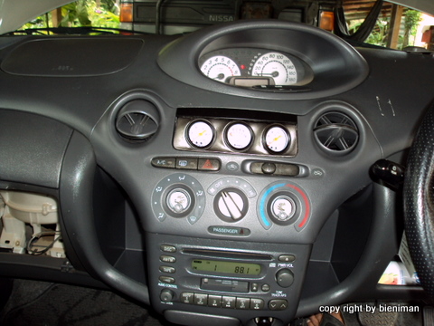

See if it fits and voilla!!! Just as if it came from the manufacturer!!!
install in the car and looks pretty ..I'm so proud...sniff...
Notice its looking at the driver...
