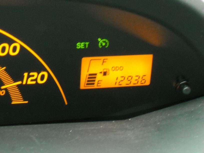

Put your new cruise control switch wire in the connector on the clock spring you took the horn wire out of and plug it into the cruise switch. Reinstall the airbag reversing the method you used to take the connectors off. There is a lot of advice out there to keep yourself grounded while you handle the airbag, you can do this by just touching the bare metal in the steering wheel assembly its grounded. Tighten the two #27 torx bolts on either side of the wheel, reconnect the battery and you're done!
SUCCESS!
