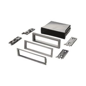

So I am doing my first sound system install on my yaris hatchback and im not sure what I need to mount my 1DIN headunit.
I bought this Metra 99-8216 kit but turns out it wont fit my bezel with 180mm opening. So which kit should I get for the 180mm opening with 1DIN headunit?

With the 180mm opening, you just need a filler for the bottom, so you just need something like this:
http://www.amazon.com/gp/product/B00...JF7SGENXNX6C8V

Aa, of course! Thanks. :)
