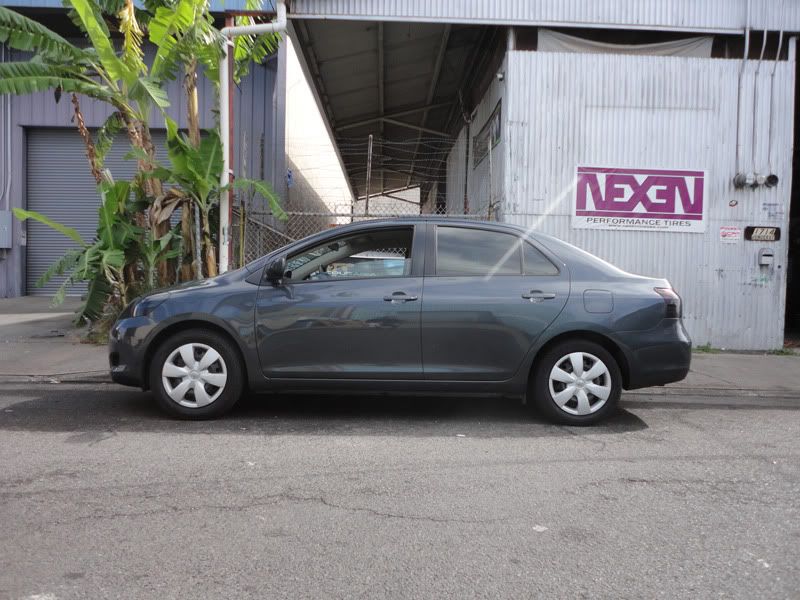

Morning shot of my baby in front of Garage Js4Kix here in Honolulu

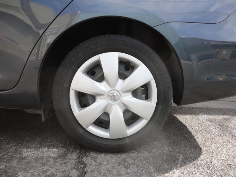

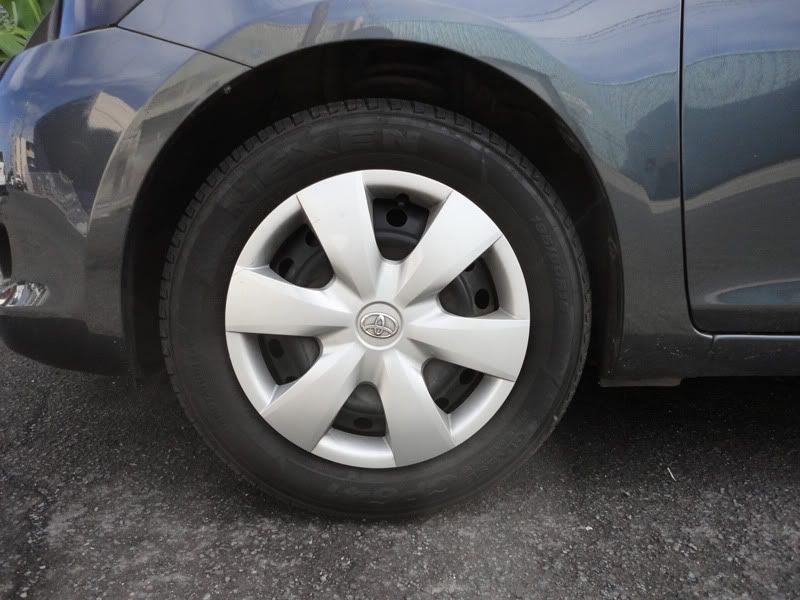

Wheel gaps

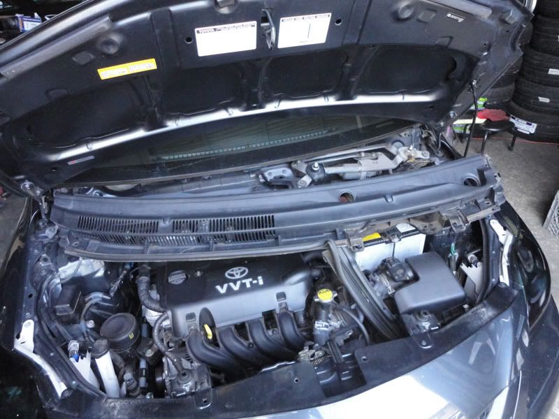

Took off the wipers, plastic (three pins) and water squirter hose

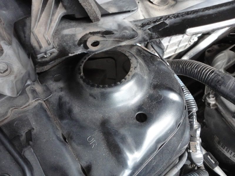

Remove the top bolt and cup

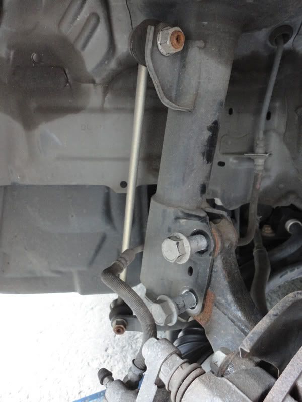

Remove the strut, brake mount, and tie rod bolts

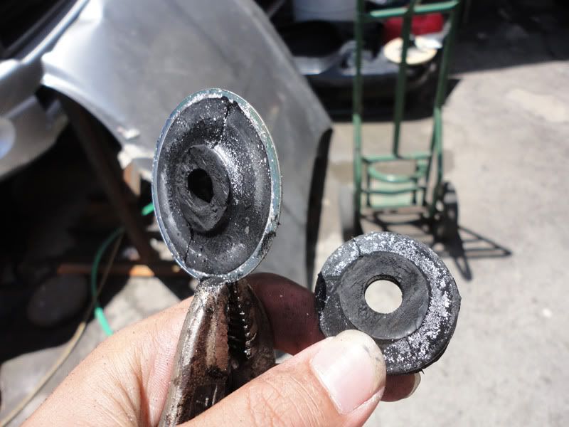

Used a spring clamp (not pictured) to hold the OEM spring to take off
a few parts (bearing, rubber stopper, top nut)

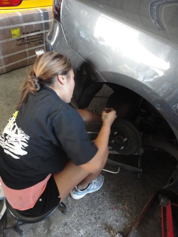

Heres the boss lady of the shop, getting dirty starting on the back
To get to the top of the back strut was a bitch. Had to remove the plastics.

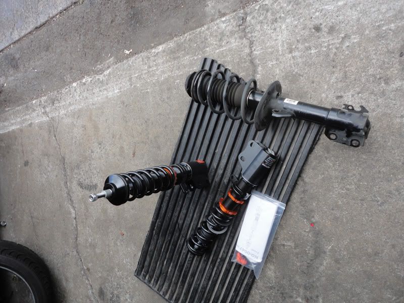

Pictured below is a guide with a rubber washer attached. The K Sport
threads aren't long enough to go through so I just cut it and added a metal
washer

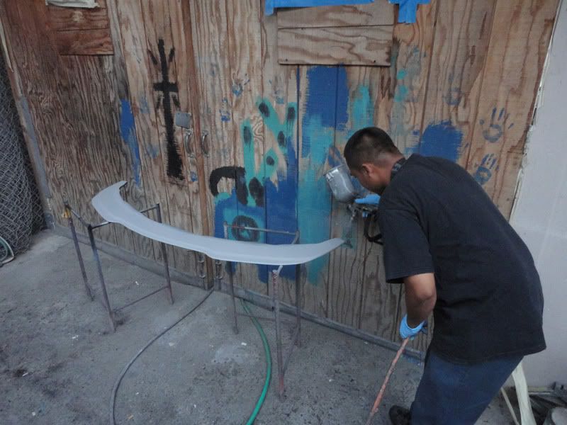

Heres an end of the day shot of shop owner Gary priming my custom splitter
