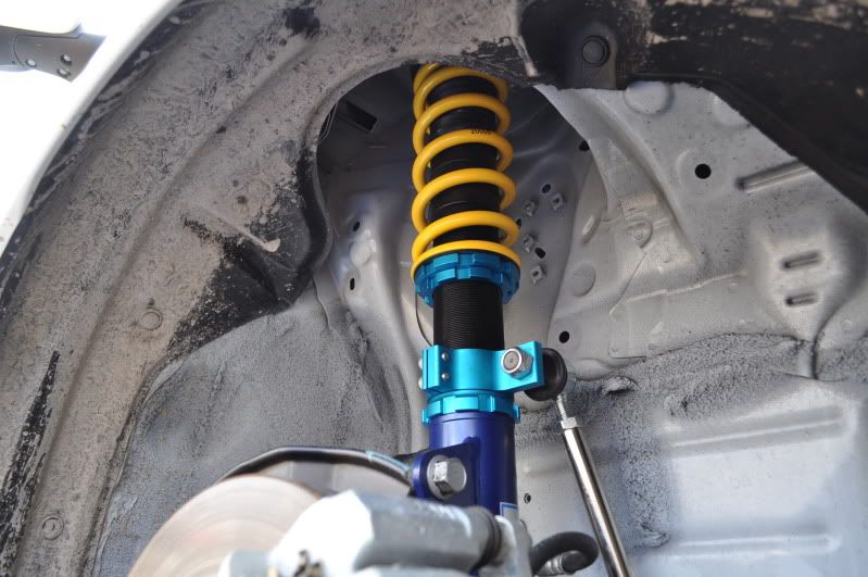

#1 = Pics below
#2 = STD R1 coilovers / 6kg front - 3-4kg (progressive rate) rear / not sure of valving, have the damping turned down pretty soft for ride. Coilovers are uber adjustable - all the front lowering is done by lowering the entire shock body in the perch (not by frigging with springs / therefore full suspension travel can be maintained) --- not sure of drop, but judging by the tuck in the front (even with tires that are .25 inch taller than stock) I'd say 3 inch front and 2+ inch rear)

nice coil though..

Your height adjustment is still done on the springs, and you can adjust the shock body so your travel is still correct with that coilover; nice.
