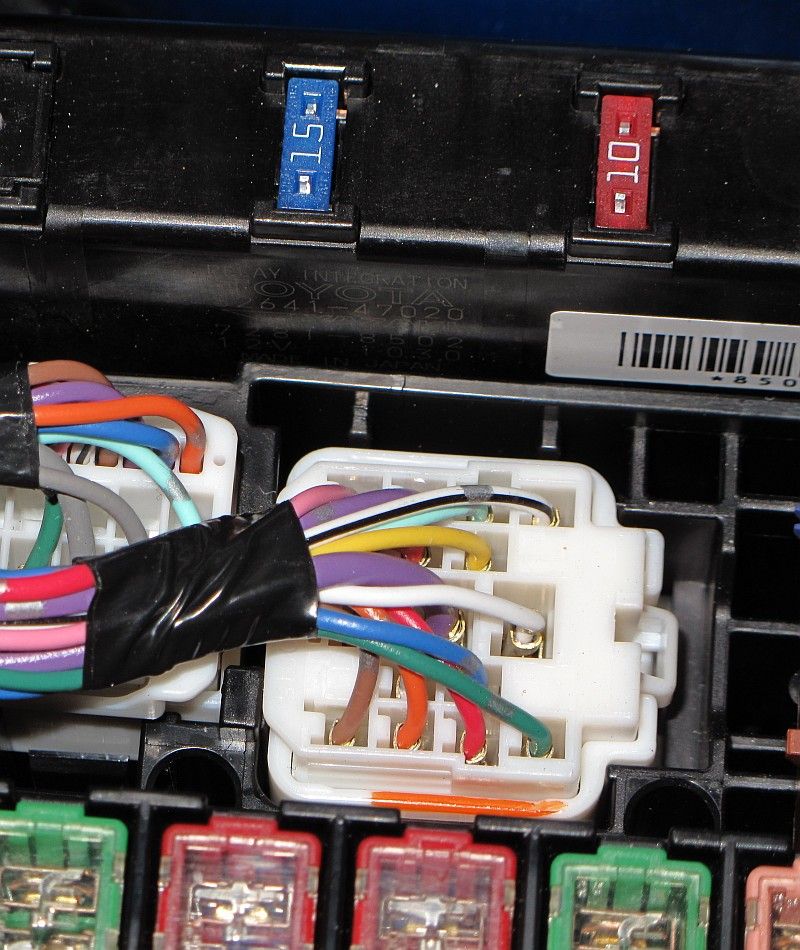

First measurement is the battery - Flip up the red cover on the positive terminal, so you can see the battery post.
1. Put the red meter lead on the + terminal and the black one on the - terminal of the battery. Measure the voltage:
2. Have someone else turn the key while you are still measuring. Record the lowest value that you see while they are turning the key:
3. Pop the cover on the under-hood fuse box. Locate the large violet wire in the center of the connector. Touch the red lead to the exposed metal on the pin of the violet wire and the black lead to the negative terminal of the battery.
Have someone turn the key and record the voltage seen while they are turning the key:

hey scott, i took off the starter motor and the solenoid, i put 12v to the starter and it works. but when i applied it to the solenoid nothing happens. is there a way that i can if the solenoid or the wiring to the solenoid is faulty? thanks in advance
aznofmuff is offline   Reply With Quote
Old 06-28-2011, 10:27 AM   #16
Posts: 13,460
On the solenoid, measure the resistance between the pin that the violet wire connects to and the large bolt terminal. The resistance should be less than 2 ohms.
