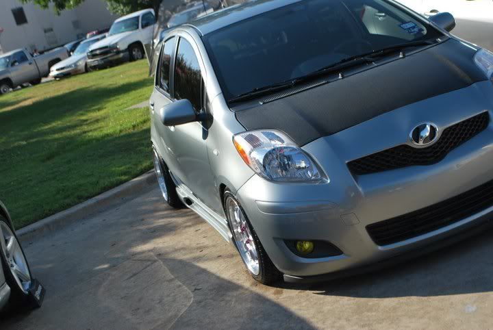

This is 16x8+0 w/ 195/50/16. Stretched just fine. You could even pull off a 185/50 if you could find em or dont mind paying the significantly higher price.
Yes this is my car, yes I daily drive it 300-400 miles a week exactly like this.
-3 Camber Shims, rear fenders rolled, pulled and widened a bit.

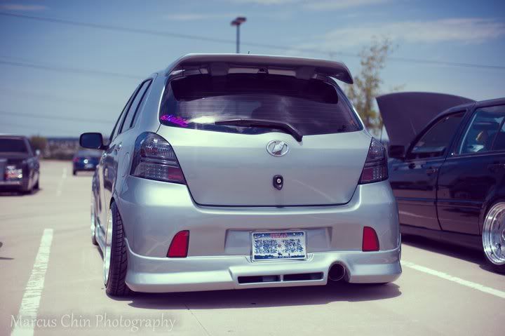

I am running 15x8 25 offset in the rear,no camber yet....DF210s for drop.....rubbing yes,bad....no....215/50s
0 offset you can run fine in the rear with camber,no camber it will look funny to be honest....
Fronts.....0 may be a bit much,I put my rears on the front to see how it looked and it was not great looking.....0 offset would be way out here past the fender.
