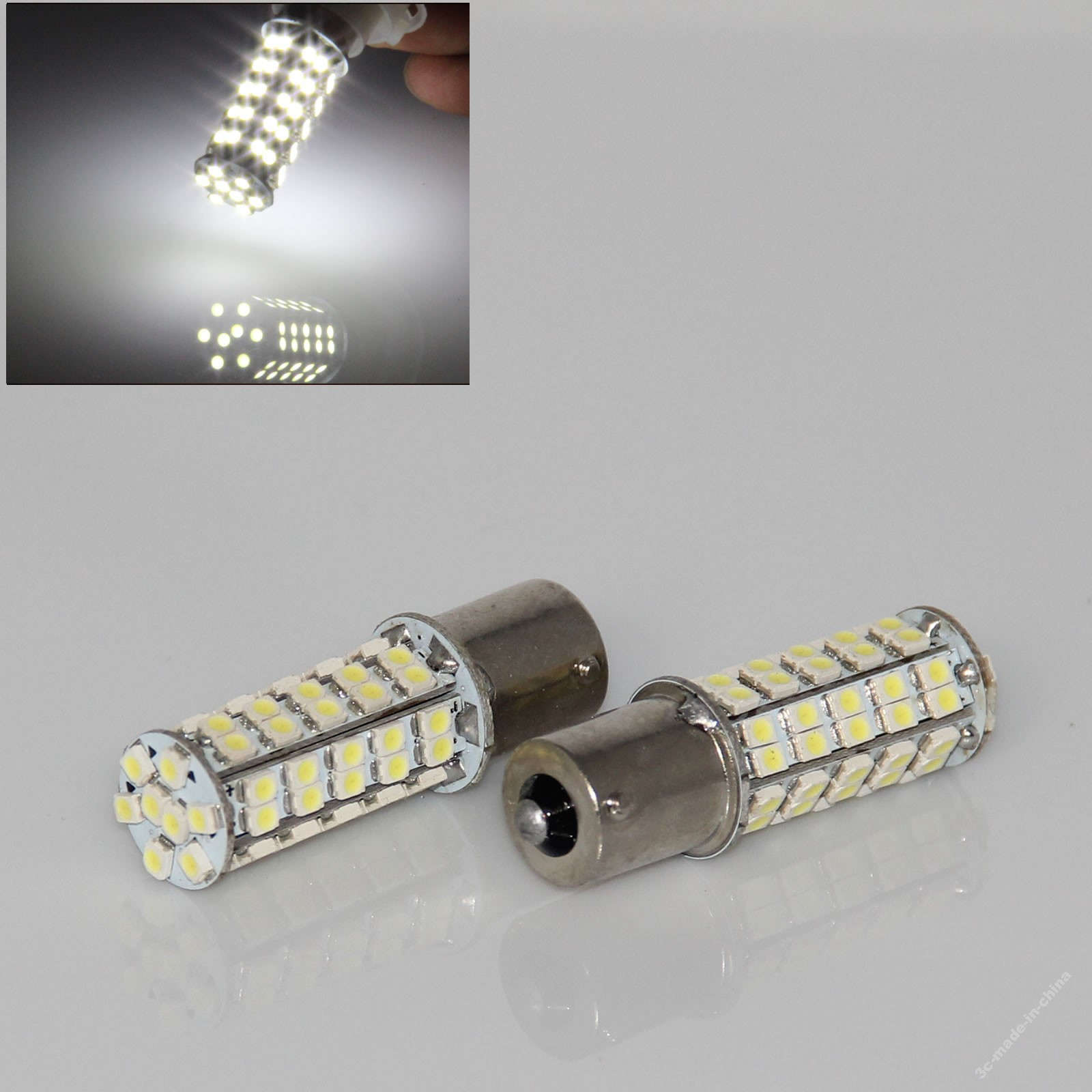

Now I replaced the brake lights. They are P21W white bulbs.
I choosed this:
http://www.ebay.com/itm/310673918211...%3AMEBIDX%3AIT
They fill up the armature better then the incandescent bulbs, but
due to the size. They have less of a "hot spot" in the middle.
Also quite a bit of light is lost in the red armature.
So maybe I shoold choose a red LED, instead of a white.
I'm thinking of these:
- They have less, but brighter LEDs
- And are red.
http://www.ebay.com/itm/2-x-High-Pow...9bafa5&vxp=mtr

Choose RED leds behind a red lens, not white LEDs behind a red lens.

White behind the red lens would turn pinkish.

100% RED LED!
White will not work very well as LEDs do not emit all wave lengths of light unless designed to. A white LED behind a red lens won't be safely visible.

Short answer: they work beautiful!
Cost around 20$ (ebay: High Power 25W 1156 BA15S CREE LED Car Tail Reverse Light Brake Light Red)
But worth it.
I have done a Side by side compare to the incandescent.
To compare it, I had replaced one LED (left) in the car, and one incandescent (right) in the car.
Very difficult to tell apart. The "bulb glass" is a nice touch.
I am happy :)
