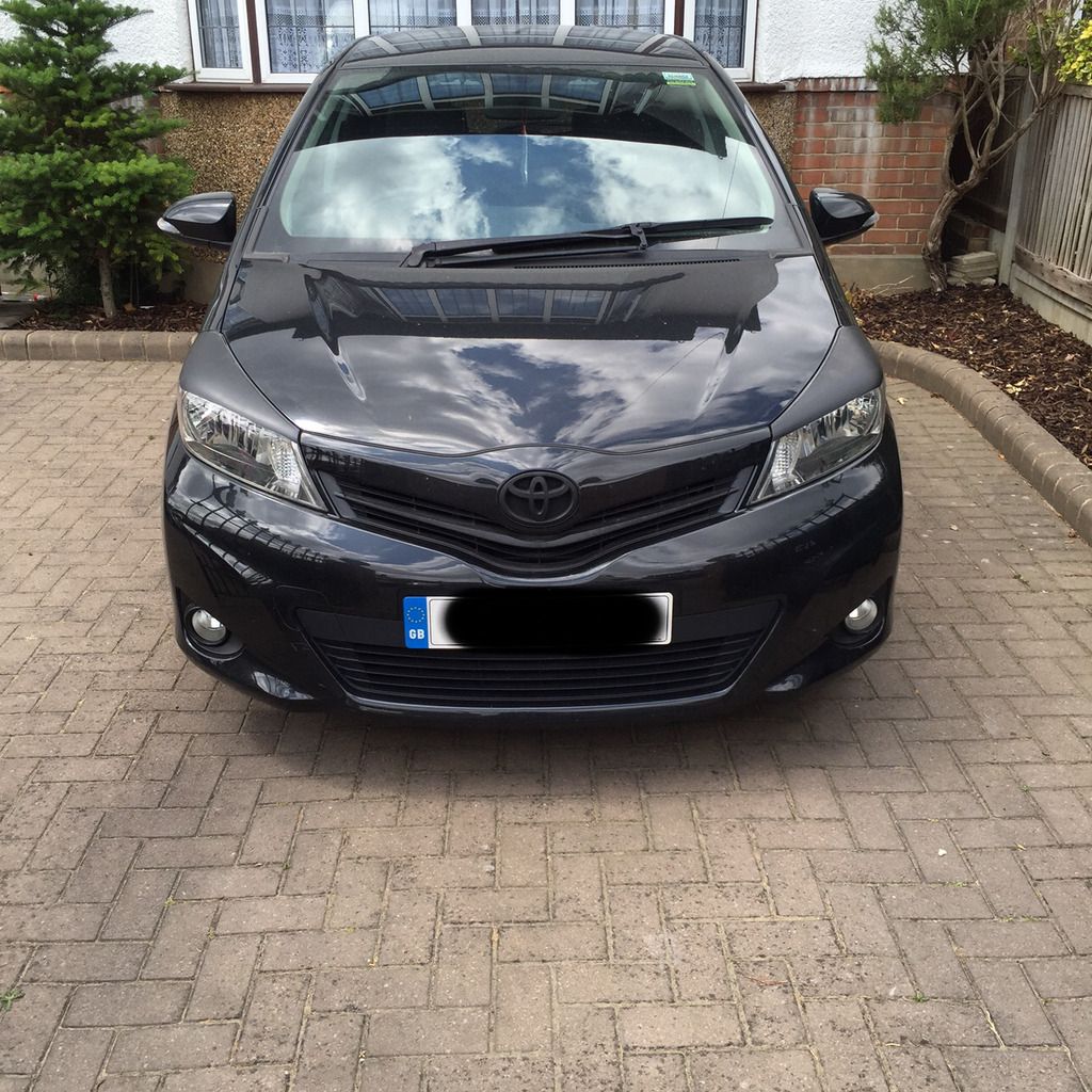

Hey guys
Been away for some time and am now currently living in AZ for 6 months. After much deliberation I have decided to go for the projector retrofit (again) and having someone help me out. I just have a question - maybe a noob question but hey - I am sourcing spare headlight housings from here in the US to ship back home after the retrofit and am just wondering if they are a straight fit to my UK shape Yaris. I'm almost certain they will be, I think the only difference is there is no light fitting for the sidelights we have which shouldn't be a problem anyway as I will be using the halos as DRL's / sidelights if not. Below is my Yaris and an example of the spare housings I'll probably end up purchasing - can anyone confirm for me if they'll be a fit?
Thanks in advance guys!

Cant guarantee it will be a direct fit, but 90% sure those ones will fit. Dont blame me if it doesnt fit haha

Won't hold you to it ha! Looking at the 3 fittings, they look similar to me, I was just wondering if the bumper shape at the fitting points top and bottom are the same with the US and UK model.
Can you imagine, a full retrofit project done here and then it doesn't fit back home - stuff that nightmares are made of...

Hahah yeah well it should fit, only the new 2015 yaris headlight wont fit. lol

USA 2012-2014 models will fit your vehicle.
If youre having a projector retrofit done in usa, keep in mind that projectors here are LHD and drive on the right side of the road. Cutoff line is opposite from that of UK. Youll have to specifically tell the person doing the projector install that you live in UK so you get the correct cutoff. I recommend http://www.lightwerkz.net, pricey but they do it right the first time. Good luck.

Thanks for the reply and heads up - already told them that the projectors are going back home and that it will be for a RHD vehicle, that was my initial thought! I'm in touch with Lightwerkz and Black Flame as we speak. Thanks :D
