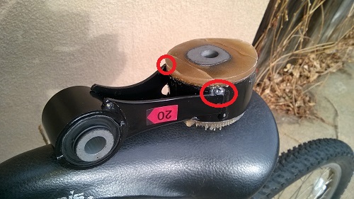

I made a mount.
i used Smooth-On PMC 770. shore 70a i bought at a local costume shop. i used hose clamps for spacers on the ends and wrapped it with gorilla tape. it turned out pretty good.

i'd post some pictures of the clamps, but i've already tossed them.
so i bought some clamps for a dryer exhaust tube. they threaded all the way, but i think as long as you are bigger than 2.75 inches i think that should be fine. on the pour side (bottom picture, previous post) i applied Meguiar's carnuba wax to the entire hose clamp so the urethane did not bond. i just clamped it on really tight. i used a new mount purchased from toyota. i did not remove the center pivot connection. (it will be fine) i did use a razor blade and remove all the excess rubber in the center gaps/edges. i cleaned with a heavy degreaser. for the bottom, i needed the urethane to be level, so i had to trim hose clamps to be flush/level. (also coated with wax.) trim circled in this picture:
then i got the black tape and wrapped it up tight, coated it with rubber cement, then another layer of tape. you can order urethane from many places, and there is many local places to buy it, sometimes. if you order "mount kits" they are usually a lot more expensive. if you buy just urethane in the shore you want, it's cheap. you can even by dye all in the rainbow. (no dye for me)
after 24 hours of drying, i removed tape and loosened the clamps. my oven only goes down to 170 degrees, so to vulcanize the urethane i put it in a few ziplock bags, tapped them up, and put my stove on 1.5. (dial goes 1-10) i simmered the mount for 4 hours at about 150 F. (66c) this is not necessary, but it will increase rigidity and longevity. i set a timer for every 30 minutes to check temp/level. used a simple candy thermometer
