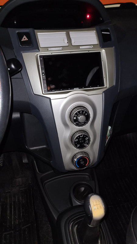

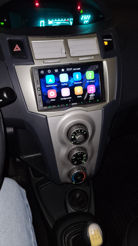

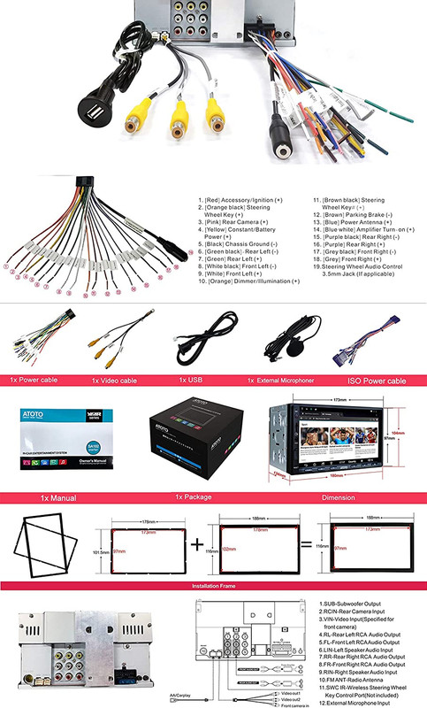

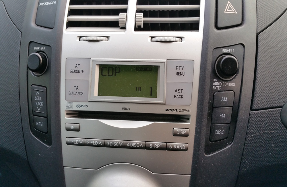

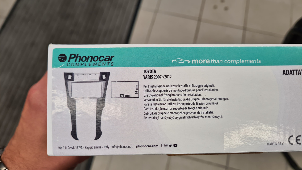

1) This is my original yaris unit
2) This is the final result after install the SA102 Starter unit
3) The 2Din frame that I bought
4) The list of things that came with the unit
Has you can see in the picture number 2 I fill the gap of the unit and the frame with a silver bezel that came with the phonocar frame. But when I have a little of time I will try with the black bezel that came with the Atoto unit (see picture 4).

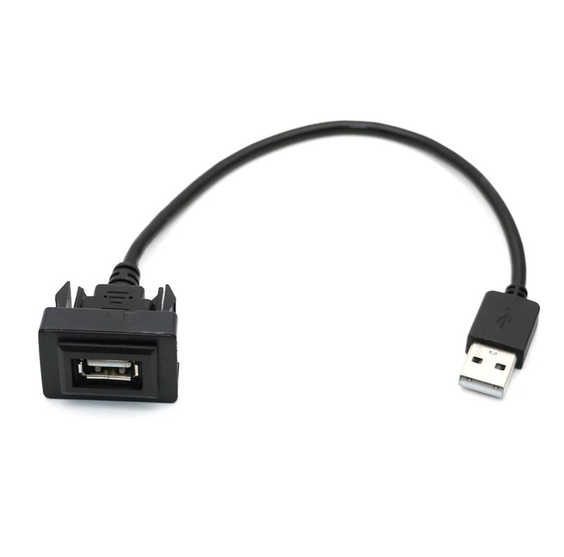

How do you install the USB cable? Did you replace the car cigarette lighter?
I bought on aliexpress a cable that feet perfectly near the hand break, but I'm waiting for delivery. After that I will know if it works. My idea is to plug this cable to the cable that came with Atoto unit.
Aliexpress cable
Atoto USB cable
I did not install the microfone but I install the black frame.
That wiring harness that you bought from aliexpress works with your steering wheel control?

Hello,
Finally arrived the usb connector for my Yaris. It take more than 2 months.
It fits perfect.
This is the finall result
The Atoto unit detect the cell phone and start the Android Auto, but the Android Auto is very very slowly to operate.
For example, when I change from maps to home screen of Android Auto it takes almost 6 seconds.
I need to try to connect the phone directly to the cable that is connected to the unit. Perhaps the problem is the usb connector that I bought or the cable USB-A to USB-C.
I will try that and later will give here the feedback.
