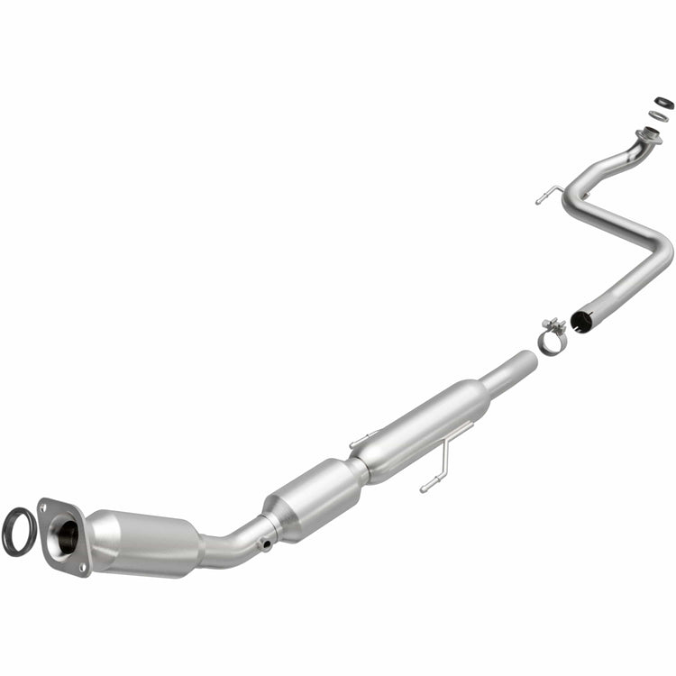

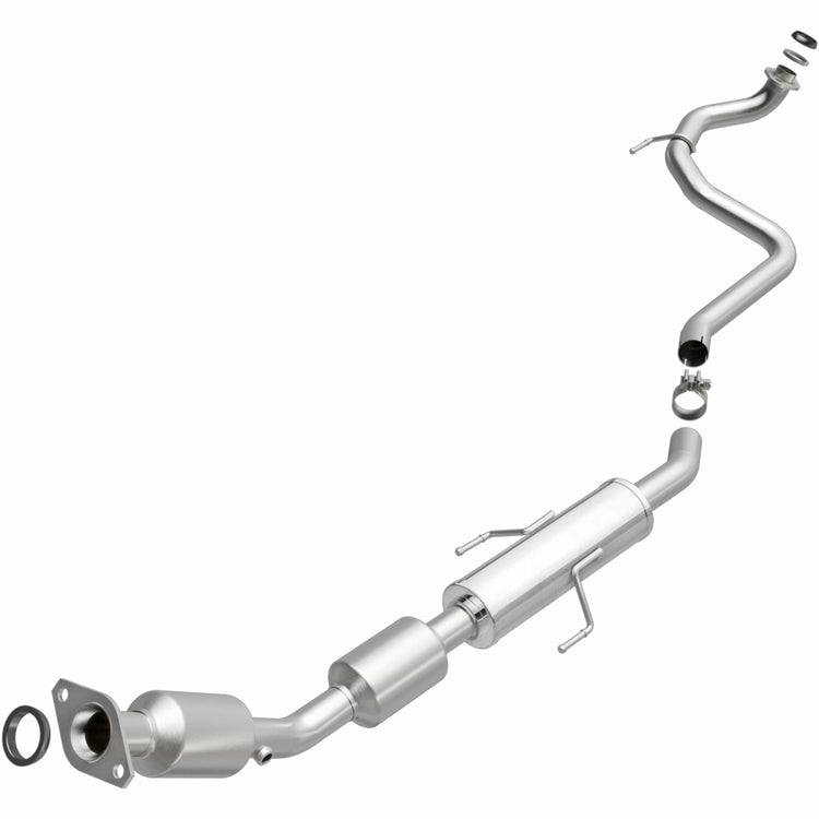

Now, for the swap, it's known that the header of the 1.8L 2ZR will not match up to the Yaris downpipe/midpipe. Interestingly, it seems that the axle-back muffler portion of the xD exhaust WILL bolt right up to the stock Yaris midpipe (see: https://www.yarisworld.com/forums/sh...ad.php?t=20153 post #8). This begs the question - is the xD midpipe the same or close enough to the Yaris midpipe to fit under the car? This could be a solution to the 2ZR swap exhaust - 2ZR engine > 2ZR header > xD midpipe > Yaris/xD muffler - does that make sense?
Here are the parts, labeled Front Pipe - the part numbers are different, but they look very similar.
Yaris https://parts.olathetoyota.com/oem-p...ipe-1741021541
xD https://parts.olathetoyota.com/oem-p...ipe-1741037270
I think I would want to go with a slightly larger diameter than stock (I need to confirm the diameter of these with Magnaflow), but these also look very similar.
Yaris https://www.magnaflow.com/products/5...ytic-converter
xD https://www.magnaflow.com/products/5...ytic-converter
Will it fit? The design and turns of the pipes look they would fit very similarly under the car. I guess worst case scenario I could try the xD Magnaflow out, and if it doesn't fit return it and go custom. Thoughts YW?
