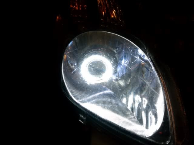

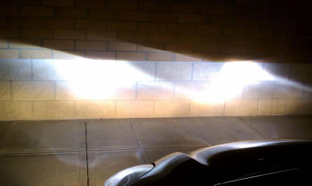

Got everything in and snapped them back together. I haven't sealed them yet because I wanted to see if the reflector bowl thing that Yaris2010RS said was true.
Now is it me, or are my cut offs backwards? Are these seriously RHD projectors? I thought the L was suppose to peak the other way to light road signs and keep it out of drivers eyes coming the other way.
I'm pretty disappointed right now. There are tons of hot spots off to the right and the right projector was pointed almost directly at the ground. I aimed them and it still seems like the right projector is pointing off to the right towards the bushes. There's a darker spot between the two lights just off center and they don't seem to light up the road very well at all.
Yeah, they look cool as hell but I didn't get them to look cool as hell. I got them because I drive a ton at night for work and was looking for better illumination.

It's in correctly. There were little stickers on the projectors that said "top". As far as the flares on the right projector, I think it might be a product of them being the wrong way in. I can't seem to turn them to face more forward. The larger section of the reflectors bowl is on the right side of the right projector so I would think the flare would be towards the center, not out to the edge.

thing i noticed with the "top" marking is because of the way out entire headlight sits on the car if u put top to top when the headlight is out of the car when u put them in they will be lopsided. i mounted my headlight many times to take them off again and adjust the position.
for your right side projector if ur sure its not reflection it could be if u didnt tighten the nut all the way (it got stuck on something and felt tight) it could yeild that result. i had issues with mine binding on something and being a PIA to tighten

as a trouble shooting process if u can i would recommend pulling out the entire projector and plugging it in and hold it and aim it at a wall/car/fence/garage just to check the cut off line. this would determine if its the install or the housing being reflective or the projector

It's ok. I e-mailed you at MI, Garm. I suppose you can disregard it. The orientation looks so like RHD projectors when looking at the cut off but I'll just have to open them up and play with them like Yaris2010RS had suggested.
I stated this in the email as well, but I'm not disputing the quality of the projectors. They seem well made and put light out like a muhfucker. It's the project of the conversion that sucks. I'll have to see why the cutoff looks so reversed when I'm absolutely certain the position of the projector marked 'top' is in there the way it should be. I'll check bulbs and all that though.
