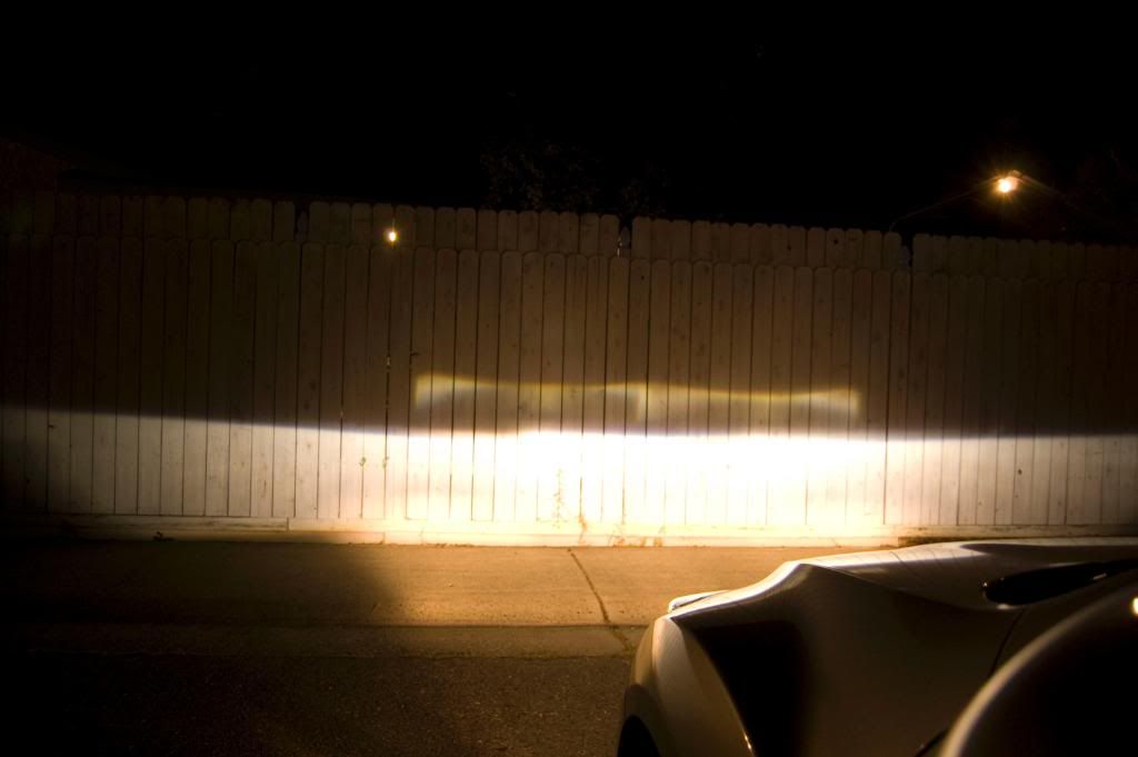

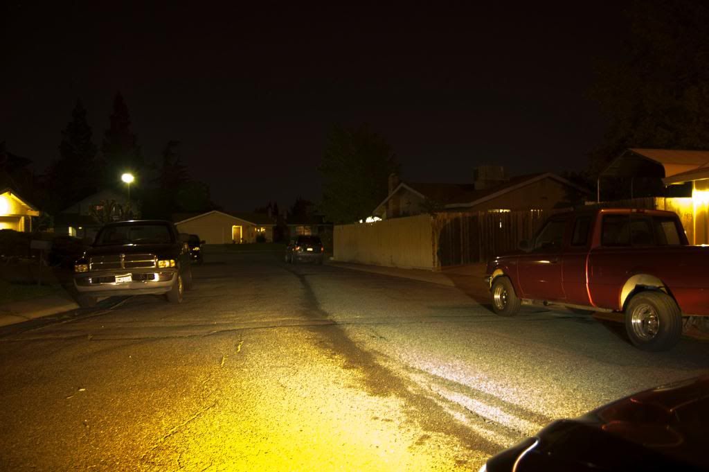

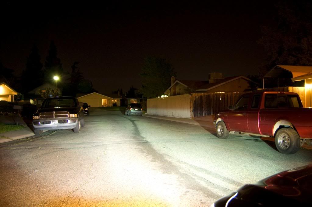

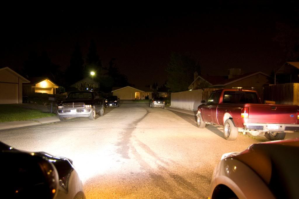

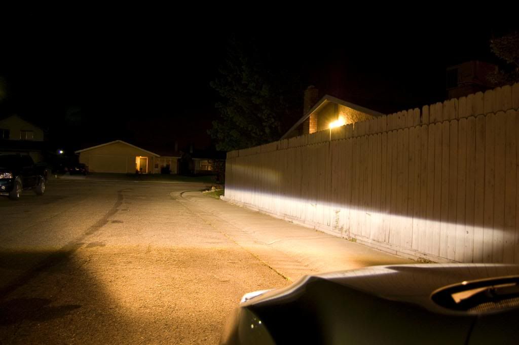

I have the G1 projectors, which provide lower light output than the G3's. Here is what they look like with the provided 6000k bulbs.
At start up and warming up
Cutoff (yes, I purposely aimed it so that it looks like stairs going up towards the right; I'm assuming yours looks like it would be to the left if you "stacked" the cutoffs?).
Comparing it to a stock 08 or 09 Mazda6 (stock HIDs)
The Mazda6's cutoff

If your cutoff looks like the picture on the box, then you have the correct, LHD cutoff.

Ah, I missed that post, but yes, those are definitely RHD cutoffs. You'll get flashed no matter what if you aim them to have usable light.

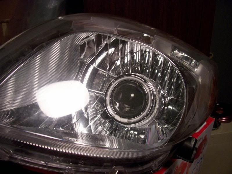

My projectors have the same cutoff....but it looks to me like they're sitting crooked in the headlights...the base gap of the halo ring should be pointing down...
The setup illuminates the right side of the road more at night.

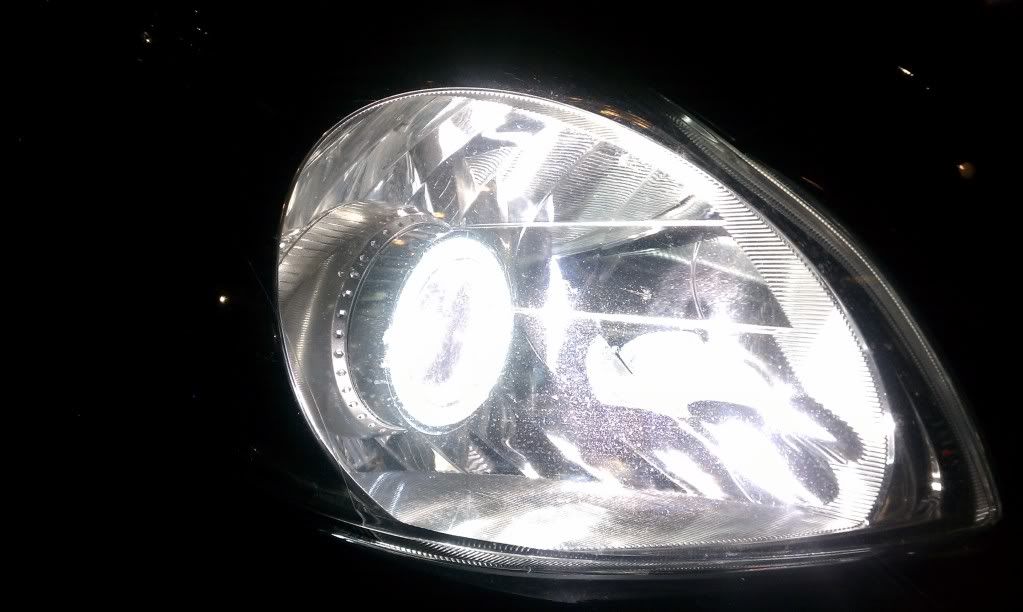

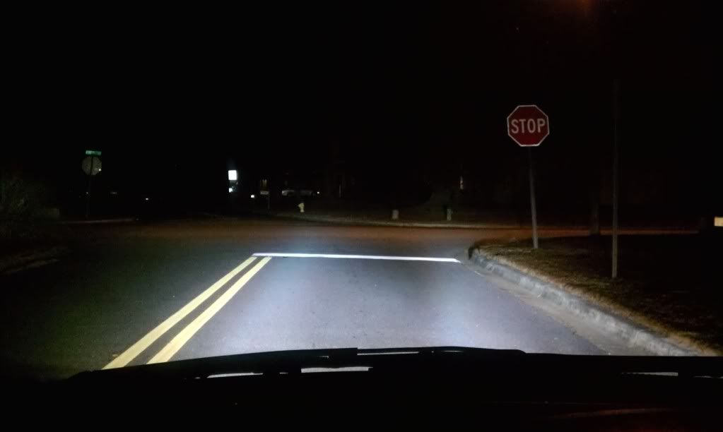

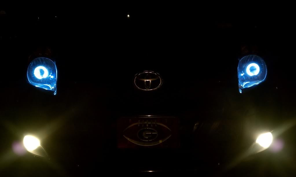

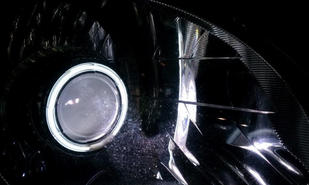

I looked into the flare problem earlier tonight here at work since I had an area with a building wall to see where light was being thrown and it appears that Yaris2010 was right. The reflectors bounce a portion of light to the outsides if they are left unpainted. I only have my cell camera on me but i tried capturing the reflection causing the flare.
Notice the speed limit sign ahead on the left illuminated, yet the stop sign closer and to the right remains fairly dark.

That's odd since the reflector bowl is designed for LHD cars so it should just throw the beam back towards the right????
Old 01-11-2012, 03:37 AM   #50
Brian
Brian's Avatar
Location: Riverside, CA
Posts: 849
No. The reflector bowl should have no effect on the light if using a projector. The projector should control all of the light output by itself. If the light coming out of the projector is hitting the reflector bowl then the projector may need to be moved out more to allow it to do its job.
And since there's not really a way to do that with the base of the projector barely getting through the hole, the alternative that people do is paint the reflectors in order to cancel out the light being thrown all over the place.
I'm guessing it's really bad on the right projector because the kick up is to the left instead of to the right like it should be, while also reflecting off that side of the bowl and getting thrown back to the right. Hence my problem with the ground directly in front of the car to the right being lit.
