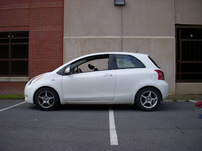

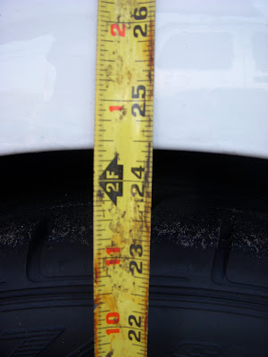

So first i measured the height of the rear wheel well stock:
looks to me to be about 24.5" roughly...

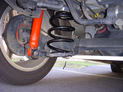

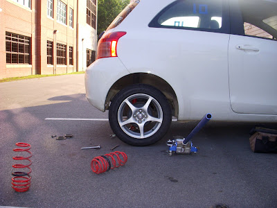

So then i jacked the car up and pulled out the rear springs. Before putting in the new ones, i took a picture of them in comparison.

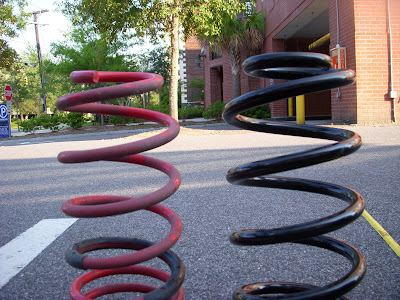

So, as you can see, they are nearly the exact same free length. Which is good that i guessed it right, but bad that it wasn't good for the rear height when it was installed! Also, the diameter of the Tanabe spring is probably closer to 5" rather than 5.5", and in fact, i think they sell a 5" spring just like these, so that may be a better option.

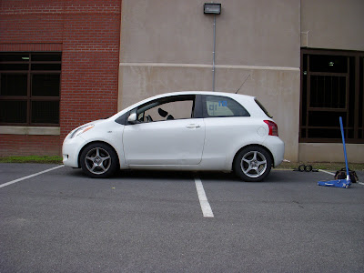

I went ahead and installed them, they just slid in and i lowered the car. The rear of the car was pretty high. I didn't go drive around on them, but i put the shocks in, and the droop length kept the springs in fine. So here are two pics, one of the height and one of the measurement of the height.
I see that as 27 1/4", so nearly 3" higher. Now, one could just trim 3" off the spring, but then i think you will have issues of losing the spring if you were to lift a rear wheel. That no good. What you could do is use the rubber hats and leave it in for another inch or so and they mostly compress. Another idea was to weld in a short metal tube that is about 2.5 or 3" in diameter on the spring seat to keep the spring in place if it were to come off the lower seat (and that would be REALLY bad. Another option would be to reduce the droop length, which is possible with some simple straps.

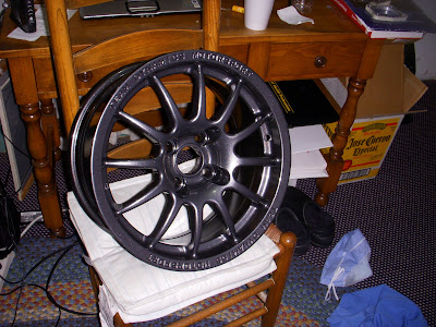

Oh, i got another nice package today too!
15x7 +25mm 13 lb Team Dynamic Spec Miata wheels!! :D so much win!!

Before
After
Can you tell a difference? I can't!! and if you dont believe me, look behind the car, black springs in the first pic, red springs in the second!
