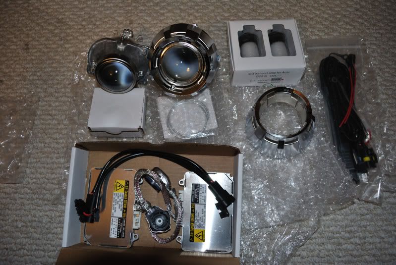

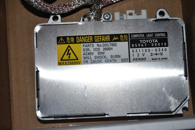

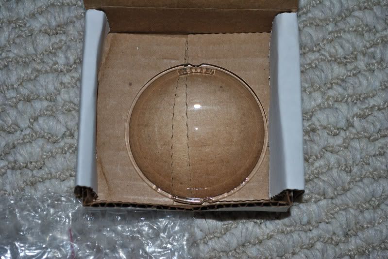

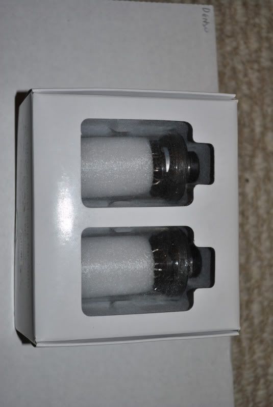

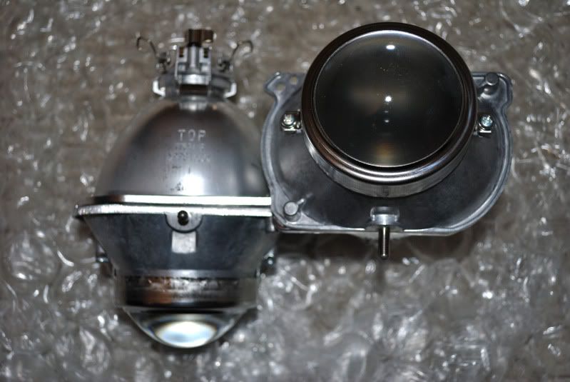

Got my parts in today for my retrofit. I'm gonna put these in the Vios headlights I have.
Everything
Lexus RX projectors
TSX clear lens

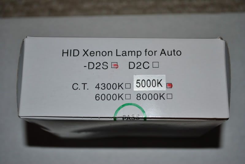

Morimoto 5000k D2S bulbs
Gatling gun shrouds

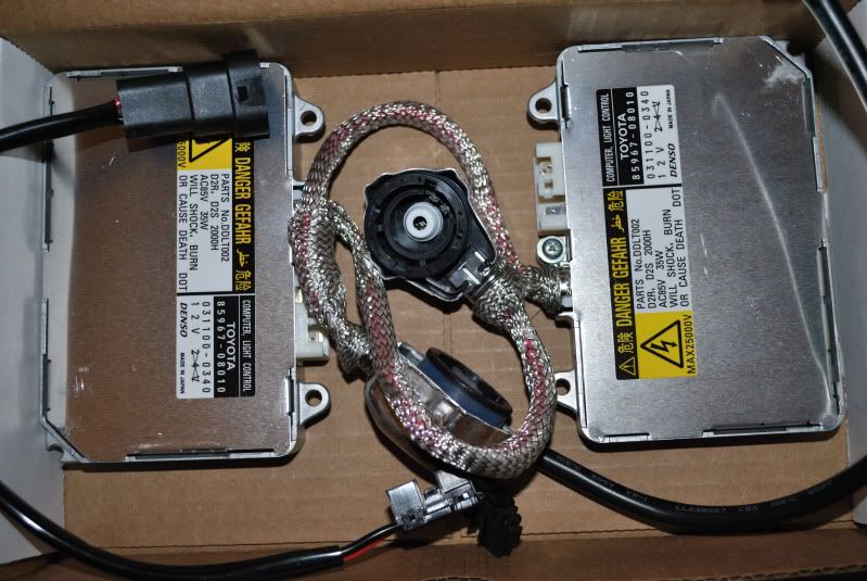

Denso ballasts

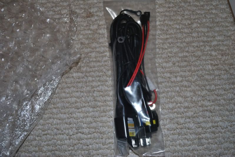

H4 wiring harness
I'm gonna start this on saturday.

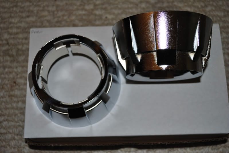

Yes, there is enough room. These are one of the smallest projectors. I wanted the S2K projectors but they won't be out for another month or two. I'll probably have to trim the shrouds because they're so big but atleast I'll know they'll cover the projector.

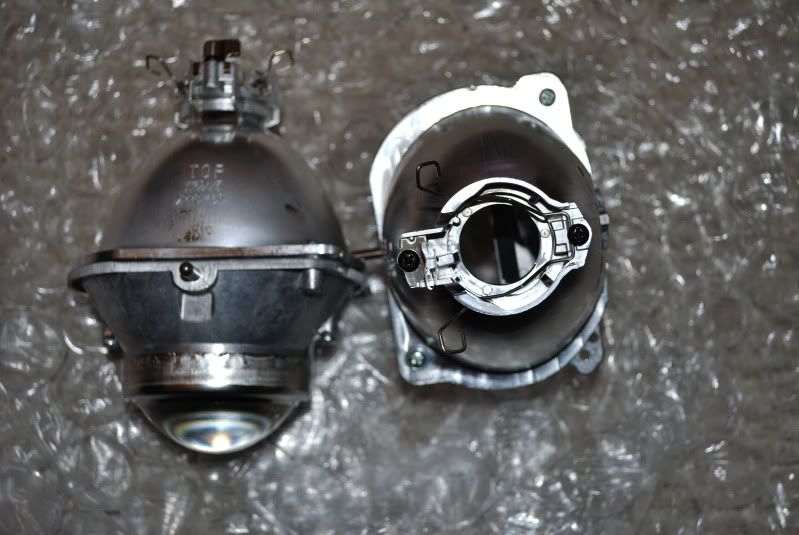

Here is my progress so far. Lens removed, sealant removed, bowl removed and modified. Projector fits nicely to the rear of the bowl. I had to trim 1/4" from the shroud to clear part of the bowl. Here are some pics of my progress.
Modified reflector bowl
Projector inside the reflector bowl
At this point, the factory adjustment knobs will still be functional. Not sure if they will be once everything is together.

Bowl modification complete.
