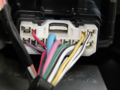

Just posting this for reference, I have a 2007 Belta (RHD), here is a pic of my stalk connector

On RHD cars the connector is mirrored, so the yellow and white/black on the right are the pins that get shorted by the stalk to turn the fogs on.
