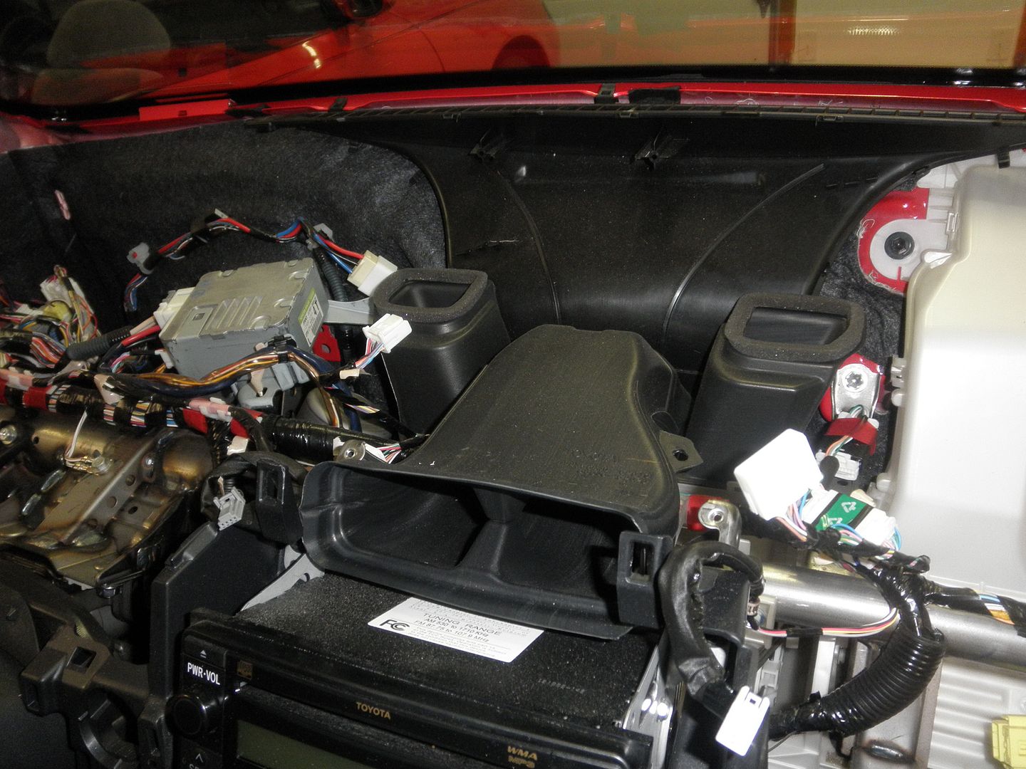

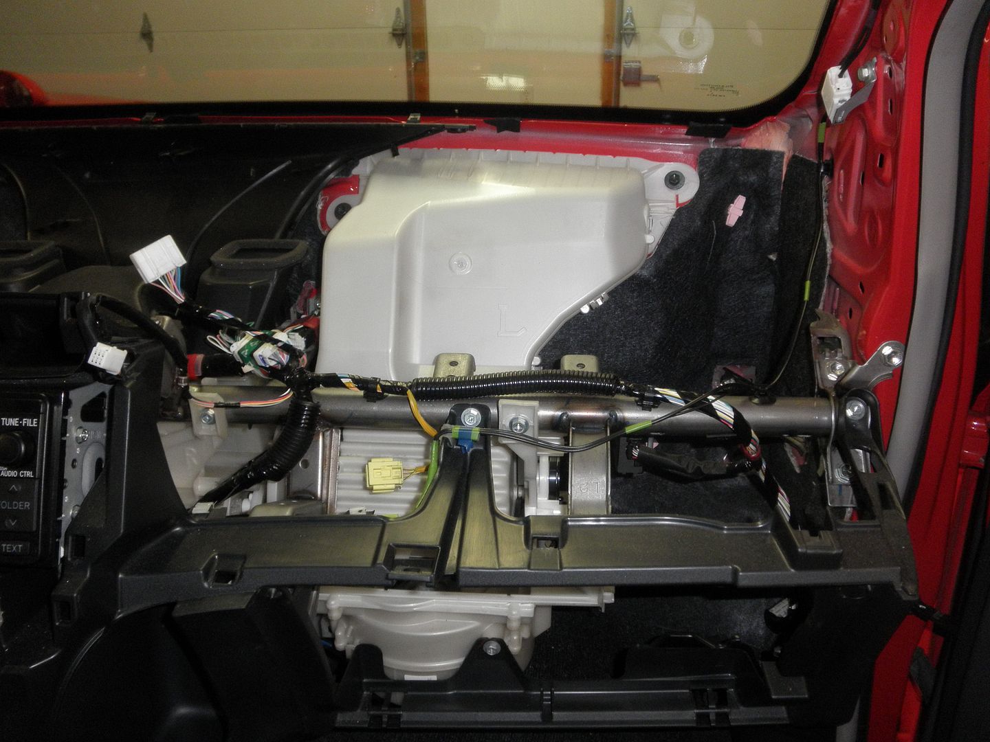

The heater / cooling part (last image down) where is that at the front of the car ? The two black square hoses in between in the middle image, where is that outside of the car ?

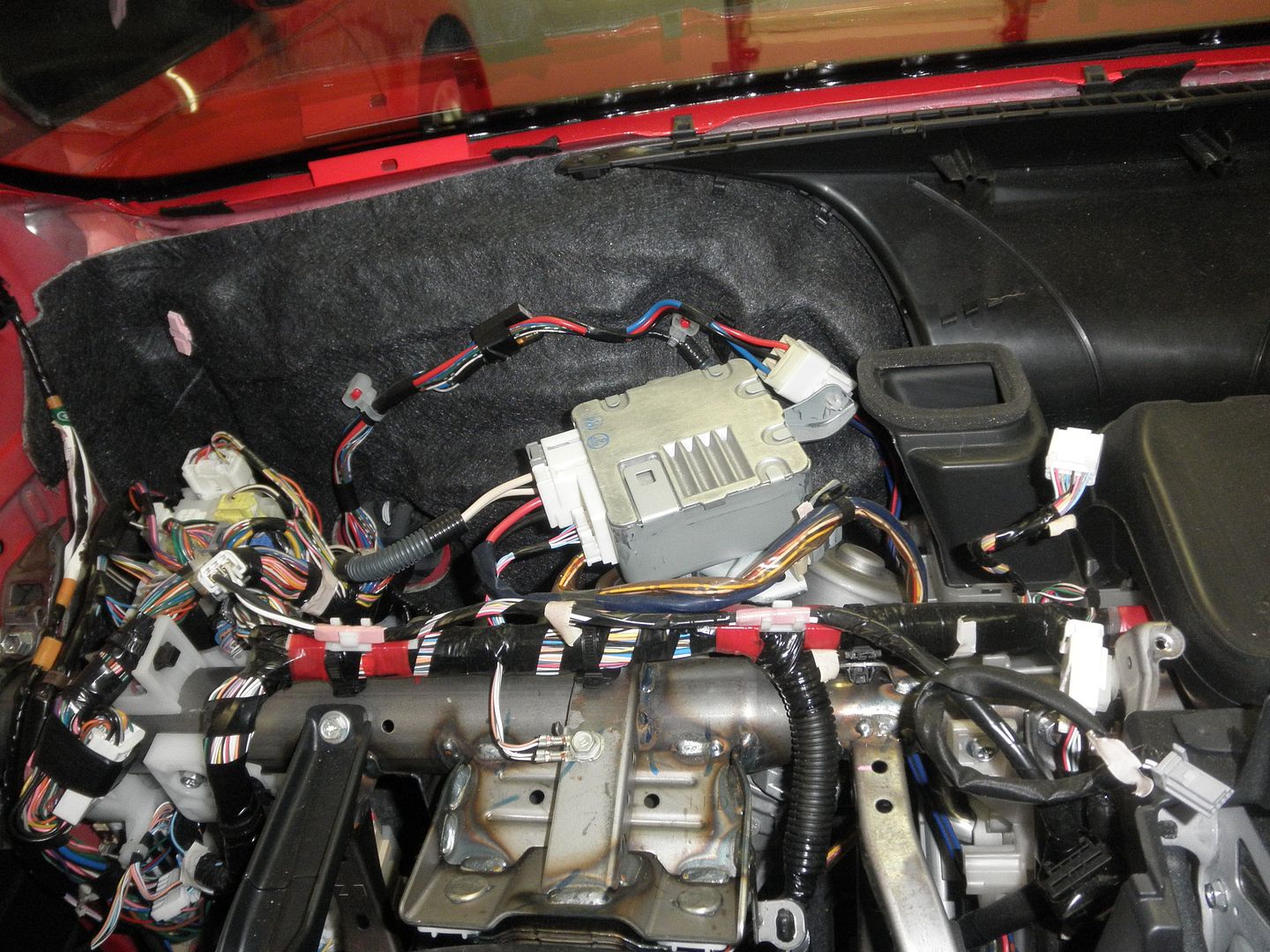

Whats the large silver box just forward of the steering wheel?

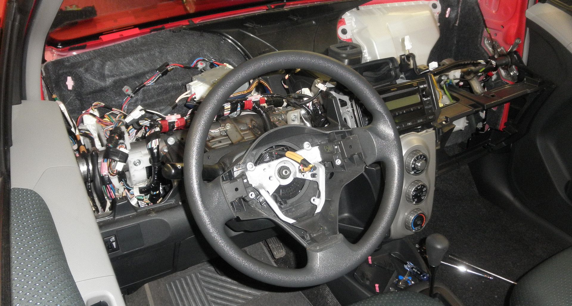

That is a second gen. The intake for the heater comes out within the wiper cowl, just above where the ECM sits on the firewall.
The black square tubes in the center of the dash connect to the air vents on the dash, they don't exit to outside.
The silver box in front of the steering wheel is the power steering ECU.
