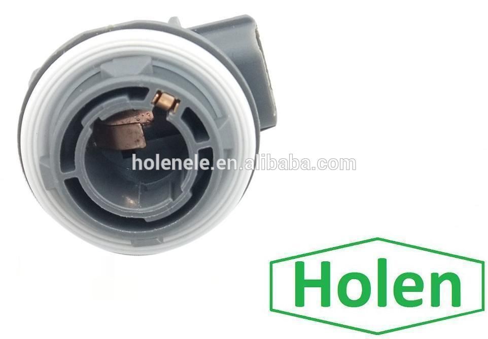

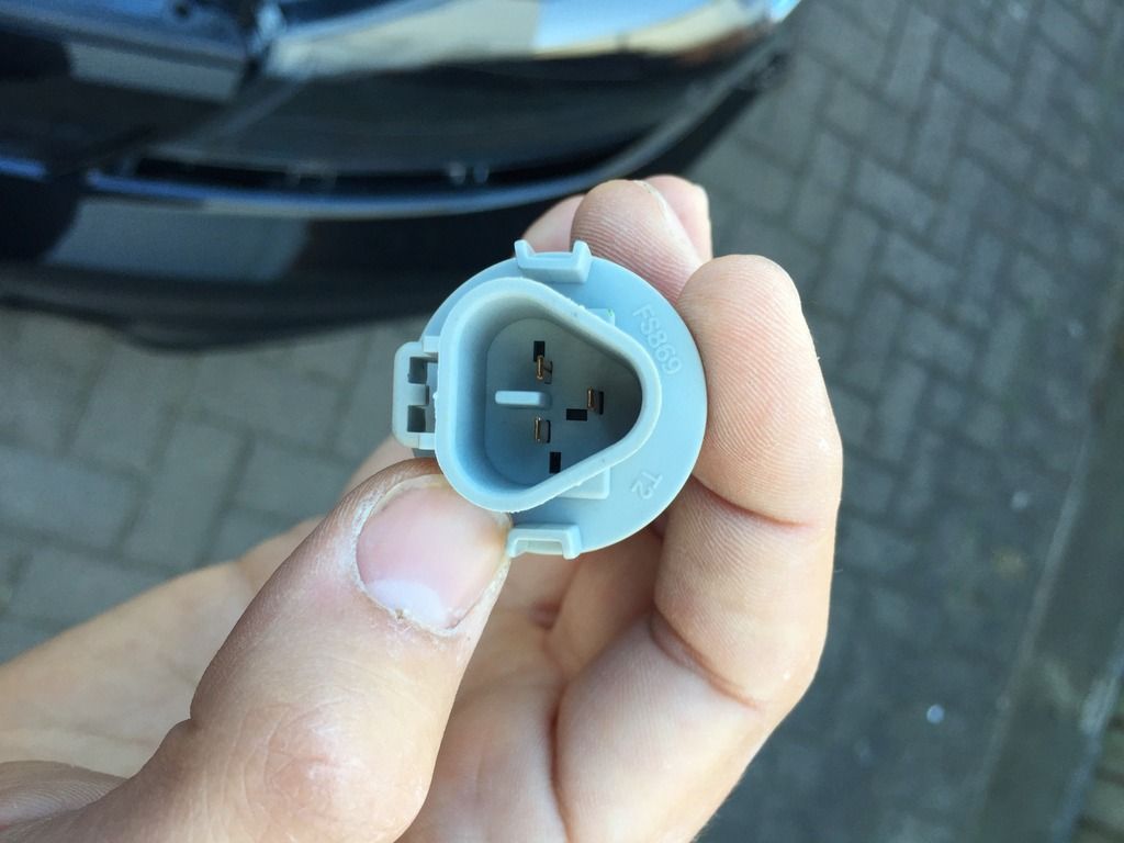

I've recently had a retrofit job done while I was in the USA and had to buy spare headlights there and they have different turn signal sockets to the ones we have in the UK. I was wondering if anyone would know of any adaptors I could use to get my PY21W (offset bayonet) to what the new one is. Or is there a way of rewiring my original wiring to this socket so I can use that? They both are very similar but mine is too big for the US socket (T2 perhaps?)
Thanks :)
Here's the photo from the US one
And a stock image of the PY21W socket

Thought so. Have you or does anyone have any advice on wiring these to my original wiring? I only have positive and negative on my indicators. I'm guessing the third on these is for a DRL function? Not mentioned here but in a separate post, these are USA spec headlights and my originals are from U.K. so the wiring is slightly different I believe. Thanks for the reply!

The two sockets are different. The one I have is too large for this headlight as they're different specs. Would you happen to know how to wire to this socket? I only have 2 wires from my indicators and this has 3 pins so just wondering which one is positive and negative. Thanks for the replies.
edit: should point out that the top image of the 3 pin is the back of the socket as it's not attached to anything yet and the bottom image is where the bulb sits in.
